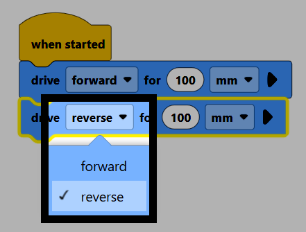

  1. Attach two drive for blocks below the when started block.
Two drive for blocks connected below when started.#
    when started :: hat events
        drive [forward v] for (100) [mm v] ▶
  1. On the second block, change the direction parameter to reverse.
Screenshot of the second drive for block's direction dropdown open, with reverse highlighted.
  1. Make sure your robot is connected to VEXcode, then select Start to run the project. The robot will drive forward, then drive the same distance in reverse.
