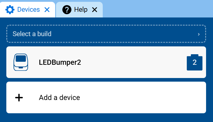

  1. Make sure your robot has an LED Bumper connected. See Configuring Devices if you haven’t added one yet.
Screenshot of the Devices tab, showing LEDBumper2 in the list of devices.

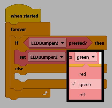

  1. Change the color parameter to green.

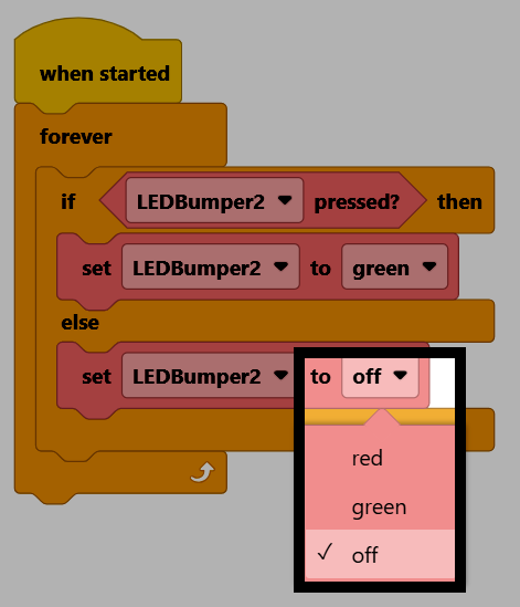

  1. Change the color parameter to off.
