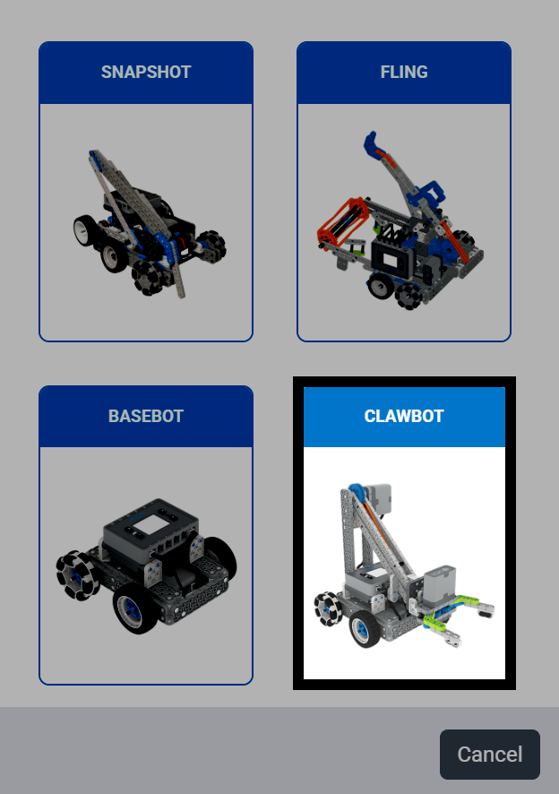

Select the Clawbot Build#
Scroll down and select the Clawbot build.
Screenshot of the Select a build screen, with the Clawbot build highlighted among other robot builds.

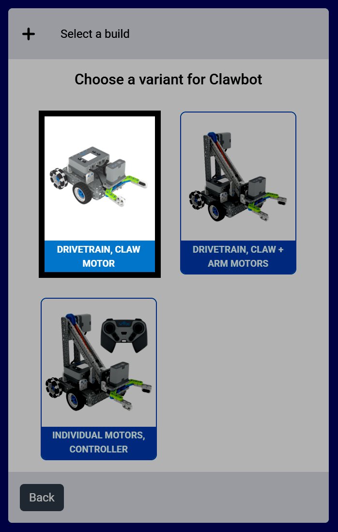

Choose the Clawbot Variant#
The build used for this tutorial is the Drivetrain, Claw Motor version of the Clawbot.
Screenshot of the Choose a variant for Clawbot screen, with the Drivetrain, Claw Motor variant highlighted.

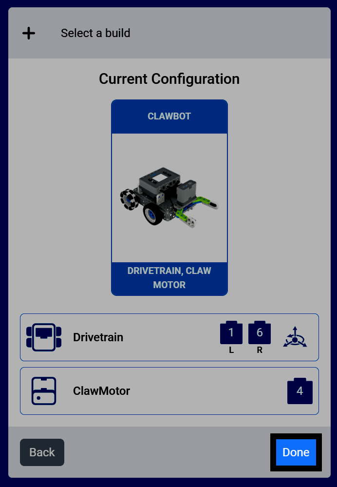

Confirm the Configuration#
Select Done to add this build to your project.
Screenshot of the Current Configuration screen for the Clawbot, Drivetrain, Claw Motor build, with the Done button highlighted.

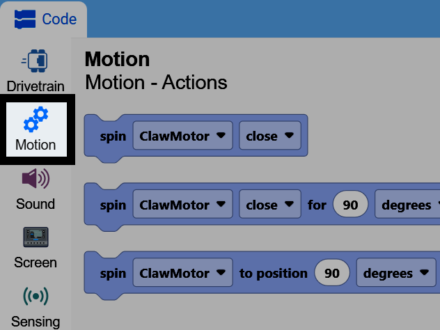

Open the Motion Category#
Select the Motion category in the toolbox to find the Motion blocks, including the spin blocks for the ClawMotor.
Screenshot of the toolbox with the Motion category open, showing the spin ClawMotor blocks.
