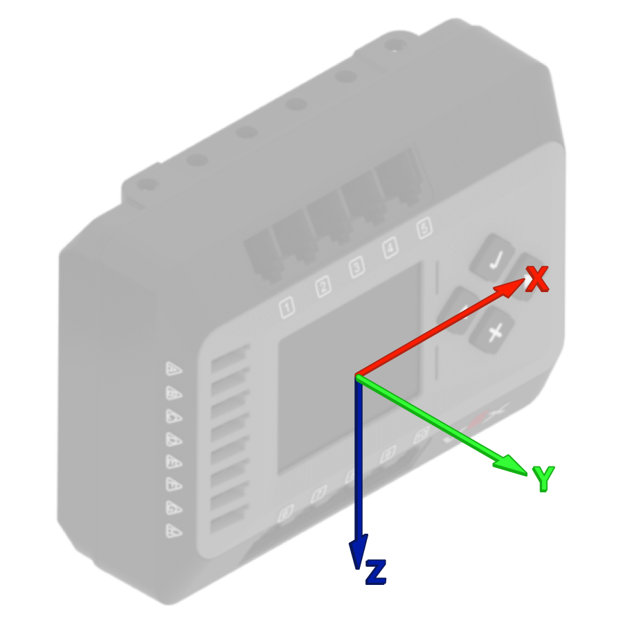

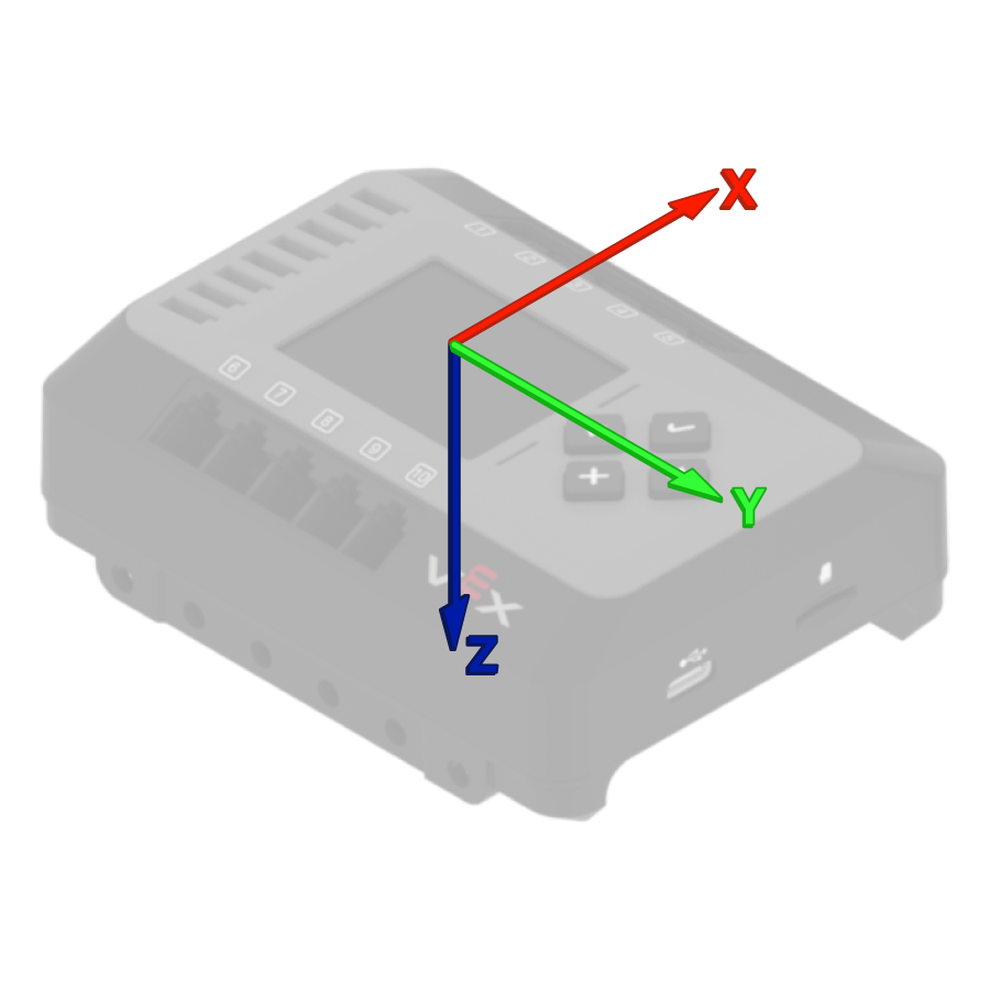

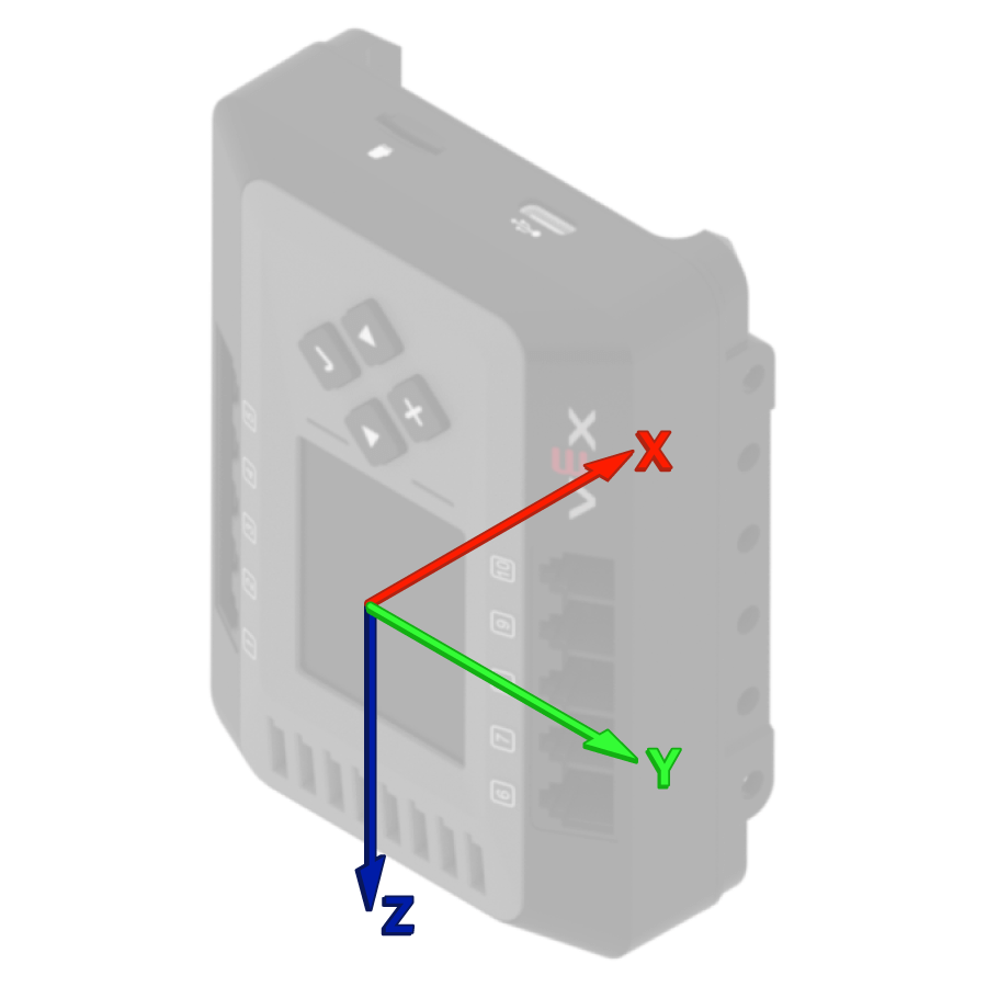

orientation#
方向是指惯性传感器在选定的转动轴上的当前角度。方向 orientation 返回惯性传感器的横滚角、俯仰角或偏航角,范围从 -180.00 度到 180.00 度,以浮点数形式表示。
横滚、俯仰和偏航描述了传感器倾斜或旋转的不同方式。
Usage:
inertial_1.orientation(type, units)
参数
描述
type
要返回的姿态角:
  • AxisType.PITCH
  • AxisType.ROLL
  • AxisType.YAW
units
可选。方向单位:
  • DEGREES (默认)
  • RotationUnits.TURNS
# Display the roll, pitch, and yaw of the Brain as it
# is rotated by hand
while True:
    brain.screen.clear_screen()
    brain.screen.print(inertial_1.orientation(AxisType.ROLL, DEGREES))
    brain.screen.next_row()
    brain.screen.print(inertial_1.orientation(AxisType.PITCH, DEGREES))
    brain.screen.print(inertial_1.orientation(AxisType.YAW, DEGREES))
    brain.screen.set_cursor(1, 1)
    wait(0.1, SECONDS)
