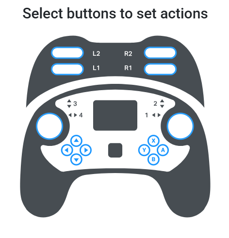

The Controller’s buttons and joysticks are shown, labeled by name. If you have a Drivetrain and/or Motor configured, you can assign controls for them here. These configured actions only run during a project while the Controller enable/disable block has them enabled.
Screenshot of the Select buttons to set actions screen, showing the Controller's buttons and joysticks with no actions assigned yet.
  1. Select a button to choose which pair of buttons will control a motor — one button for the forward direction, and the other for reverse. If multiple motors are configured, both pairs of buttons can be selected at once.

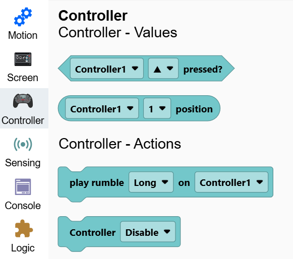

  1. The Controller category will now appear in the toolbox, containing its blocks.
Screenshot of the toolbox with the Controller category open, showing the Controller1 pressed?, position, play rumble, and Controller Disable blocks.
