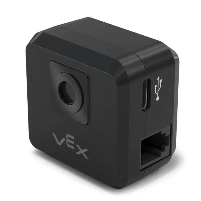

The V5 GPS (Game Positioning System™) Sensor provides accurate position and orientation tracking for a robot on the VEX Field. It uses the GPS Field Code around the Field’s perimeter to calculate the robot’s X and Y coordinates and heading in real time.
The GPS Sensor returns the robot’s position using a reference point automatically calculated from the offsets entered when configuring the GPS Sensor in the Devices window.
For more information about the GPS Sensor, read Using the GPS Sensor with VEX V5 in the VEX Library.
The reference point acts as the GPS Sensor’s own (0, 0) position where all coordinates, headings, and movements returned by GPS blocks are relative to this configured point.
The VEX V5 GPS Sensor.
